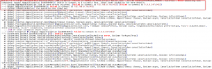

Hello, form the image you shared it appears the script is unable to link to the sql server. Do you mind sharing a snipped of how your setup looks like for further advice?

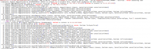

Hello, I have encountered an error with the call flow logs, as shown in the attachment.
And the CFD dialer configuration is shown below.

What you shared in your last screenshot is not an error. You have an issue with the connection to your database.
A timeout is usually related to a firewall blocking the connection.

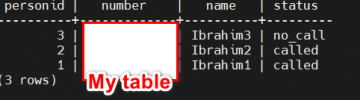

Dear Edo,
Thank you for your assistance.
Please find the predictive dialer project with the database query and table attached. I would like to ensure accurate number status updates and implement best practices for the predictive dialer based on your perspective.
The Make Call component will wait for the call to be established, during the time you specify. This could be a long time, for example 30 seconds, and during this time, if you don't update the database, another parallel dialer might run the query again and get the same number. You should update the status of the number as soon as you return it, maybe to a temporary status like "calling", and then again once the call has been completed.
