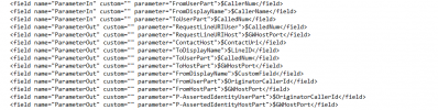

So it's correct. 1620 makes the forward so the call will match the outbound rule of group "TEISING". And I am guessing you have originator call ID configured on your trunks so it shows the caller ID of extension 1740.
These are the Parameters and OrginatorCallerId is configured on FromUserPart and P-AssertedIdentityUserPart.
Thats I think the default on the template for telekom sip trunk.
Should I change the FromUserPart Paramter to something else?
Just checked all Telekom templates (DE) and this is not the default configuration. I am not sure which Telekom product you are using but they usually use the PAI header for authentication.
If you are using a supported Telekom product, delete the trunk and recreate it using the default template and check.
Im using Telekom CompanyFlex Voice Data Template. I'll try to recreate it and I'll let you know. Thank you very much!
