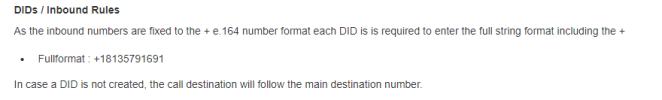

You will have to also make sure that the DIDs are configured in E164 format in the SIP Trunk.

When you say E164, you mean in the SIP Trunk settings under the DIDs tab it has the proper + country code? Or do you mean the Caller ID tab options.
Yes that is what I mean. In the SIP Trunk configuration >> DIDs >> set up the DID in E164 format.
