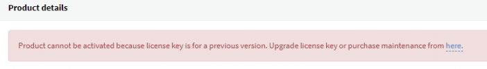

i have a problem with my license.
I have 3CX version 16 self hosted but my license certificate says version 18.
Is there a way to "downgrade" the 3cx version in the license?
Thank you.

Thank you @NickD_3CX but unfortunately at present when i go to the license page i remains stuck on:
We have another installation with a different license and it does the same thing. Are there problems with the license server?
This was just very bad timing. When you tried to refresh it, there was an OVH outage that affected all activations.
Please try again now and you should be OK.
