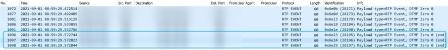

The fact that you see it being sent multiple times is actually expected and is nothing out of the ordinary. Since yu've already got a packet capture, what I recommend you check for next is the packets denoting the end of the DTMF input. You will not see these in the SIP Flow so you could filter the capture with "rtpevent". You should see something like this:
As you can see there are 5 packets to denoting a single DTMF input and then 3 packets denoting the end. The number of packets denoting the DTMF input may vary depending on the endpoint used (IP Phone, 3CX App, etc) but the "end" packets should be three.

1: THere are 3 end packets as your describe
