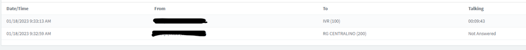

the ring group for no answer is configured to forward to digital receptionist. trunk > ring group, if the two member of the ring group not respond or arent available the call is forwarded to digital receptionist with selection and other collegues that pick the calls. also in this case the call are not logged correctly. the ring group member not responded then the call was forwarded to IVR and someone from the IVR member responded but in the log i see only IVR (100) for 9:43 minutes so it not be logged to the user/operator that has responded
This screenshot is taken from the 3CX Call Logs. But what about the call logged in the CRM? Is it logged for the extension that picks up after the Digital Receptionist?
no, is logged to my user as owner (like voicemail call) and without indication of the extension that pick up

Well, the call journaling entry not showing the extension number explains why the call is logged for the administrator. What's weird is why the call is not related to this extension, both in the 3CX Call Log and the call journaling entry. Can you please re-check this once Update 6 is released? The Release Candidate will be available very soon (maybe tomorrow), so the final release will not take long.
