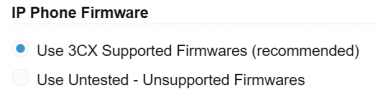

You can clear your firmware by switching to untested under Phones > Options:
Then press OK and it will wipe the firmware from your machine.
Change it back to Supported, and press OK again.
Go to the System>Updates tab, you will see the firmware there and you can download it.
Finally, upgrade only 1 phone, confirm it was ok, then upgrade the rest too.
Thanks for the assistance; it worked.
