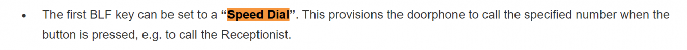

does anyone know this provisioning not happenning properly ? Basically the DSS Key to call an internal extension is not going through when this doorphone reboots ,it registers but i guess this only one portion not provisioning properly .

Ok this is normal then. You selected "BLF" type, which is not valid for this type of device.
As per our guide, it needs to be of the "Speed Dial" type.
https://www.3cx.com/sip-phones/fanvil-sip-doorphones/

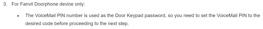

Also i have a quick question lets say i provisioned it with 3cx template and i make change for the code to trigger the relay to open the door strike to something like number "5" (because that was the code used to use for Panasonic system and i come from the back ground Panasonic ) and after that if the phone reboots than is it going back to the provisioning template or is there a way to stop this after some changes made OR ids there way i can change this in the template at the first place and don't have to worry about anything after wards.

So another words this is how i should be doing it .
Step 1 Factory reset the Fanvil 130
Step 2 Make sure the VM Pin is setup as desired to energize the relay by manually entering it on the door phone itself
Step 3 Provision the phone through SBC ( i have one on site)
Step 4 Change the DTMF Code after
And as per you it will stay like that forever ,doesn't matter the devices reboots or not ?
Exactly correct, it will stay this way even after rebooting.
Only a factory reset will remove this setting as far as I know.
