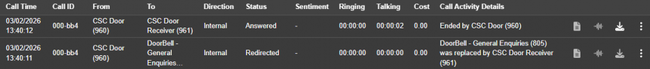

what does the 3CX call report show? That the i53W answered the call even though you did not press the answer button?
Hi
Yes it does ....
Ive checked all auto answer areas and preview etc and all turned off ...
And yet, it still answered it even though you are confident that this is disabled.
