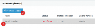

If select Phones>Firmware, it says device version is up to date but Updates>Phone Template says status OUT OF DATE installed version 124474 Online version 124479
Download the new templates
I would click the download to update the template and it would not allow me to select it. I now see out you have to select the line of the update and then download it.

I think you may have confused the firmware with the templates.
Just go to the updates tab, 1. click on the template, and then 2. click download
Then reboot your phones or reprovision them so they can receive the new settings.
Done!
Yes... That took care of it.. Thank you very much.
