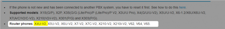

The information in the provided link is clear, only the X4U-V2 can be a router phone:
This must be the model and not update an X4U to the latest firmware that will work like an X4U-V2.

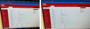

Please look at the following image. They are from exactly the same phone (where the physical phone label and the box says "X4U"). The one on the left is before firmware update, the one on the right is after.
The model changes from X4U to X4U V2 after the firmware update.
Also after the update, it works fine on 3CX as a router phone (X4U V2).

Yes this might change however the label in the back of the phone what information gives you?
@BElias V1 and V2 phones contain different hardware and their firmware is not interchangeable.
- You cannot upgrade to a V2 using a firmware update.
- The V2 hardware will say "Rev.B" in small letters on the back label.
- Your UI also shows Hardware V2.0 which indicates this is indeed a V2 phone.
My guess is the factory firmware was old and inaccurate and you probably do indeed have a V2 device, but confirm via the label please.
