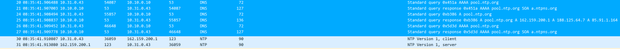

Ok then at this point I would advise to try and mirror capture a LAN port on your switch, and then power up one phone connected to that port.
In the capture you will see some useful information from the start up procedure like:
- does the phone send a DNS query for pool.ntp.org?
- does it get a reply?
- if it gets a reply, does it contain a valid IP?
- does the phone contact that IP?
- if it contacts the IP, does it get a valid NTP response?
Here is a healthy example of traffic
..and the contents of the reply from the NTP server
I'm by no means an NTP expert but if the above conversation does not take place, I'm fairly certain your phone will not pick up the correct time :)
If you succeed, the hour may appear wrong (due to localization settings), but the date at least should be correct.
Thanks for the reply. I was able to use this above method to supply additional information to the client network company. They were able to resolve the time issue with this information.
