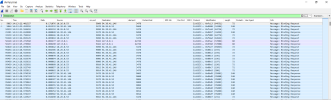

packet capture is run on 3cx and on the firewall internal and external interfaces
packet capture shows that stun and alg servers are being resolved, but I never see a connection attempt to either

I'm really trying to figure out what the firewall checker is doing since packet capture seems to show it doing nothing, this way I can see what might be broken in my config

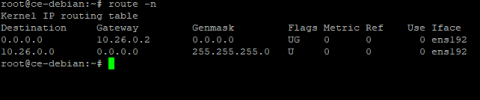

Please see a supported installtions ifconfig, they should all look something like this:
your route -n should look like the following:
Again we have though not that we have never tested nor provided support for the Proxmox Virtual Environment. Or can comment on what you have mentioned above.
I dont see anything wrong with the network config I posted, however I'll post again using ifconfig and route instead of the newer IP2 tools

root@3cx:~# route -n
Kernel IP routing table
Destination     Gateway         Genmask         Flags Metric Ref    Use Iface
0.0.0.0         192.168.1.1     0.0.0.0         UG    0      0        0 ens18
192.168.1.0     0.0.0.0         255.255.255.0   U     0      0        0 ens18
root@3cx:~#
