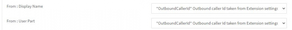

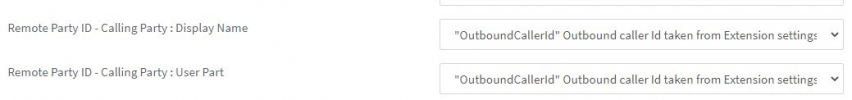

In that case you could alter the SIP Trunk's Outbound Parameters a bit. Just change the "From: Display Name" and "From: User Part" parameters to use the OutboundCallerID taken from extension settings as seen below:
Just bear in mind that we do not generally recommend modifying the default settings of a SIP Trunk if using a 3CX Supported provider as it will affect behavior. For instance, doing so would prevent you from being able to present the originator's caller ID outward in cases where an external call reaches your PBX and is then forwarded outward again.
So that is not an option.
Also: please not that the Outbound caller Id taken from the Extension is NOT used by 3CX for the outbound call as i have described in my initial post.
That means: the option you have posted above is not working correctly!

It should if you change the outbound parameters I mentioned. Please read my whole post.
If you do not want to modify the parameters nor use any of the other workarounds I have mentioned then there is no other way around this. The configuration you have implemented is not what I would call "conventional" as the components used were not meant to do what you are trying to do (e.g. use an extension as a "shortcut" for an external number) so I'm afraid I cannot suggest a configuration that would suit your case and also be considered a 3CX Supported configuration.
I agree. It SHOULD work.
Afaiks i am not using an exotic configuration. I JUST filled out the mobile number for an extension and ticked the box "Ring my mobile simultaneously".
When i dial the extension from another extension the WRONG headers are send to the trunk. To be clear: the headers that are send to the trunk are NOT the headers that are configured at the "From: user part". So i still believe this is a bug. I realise that many trunking providers "fix" an invalid From-header, but 3CX should send out valid headers. EXPECIALLY if they are configurable as ChrisC_3CX pointed out above.
