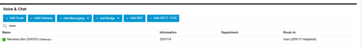

We are currently testing an upgrade from 3CX Version 20.0 Update 6 (Build 724 Release) to Version 20.0 Update 9 (Build 995 Release - AI 1.4.48).
After completing the upgrade, we noticed a change in the Voice & Chat → Gateway configuration.
Before the upgrade, the gateway configuration displayed the trunk/gateway details, including the configured trunk information.

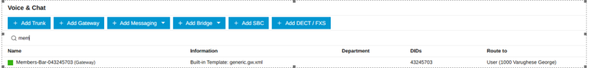

After upgrading to Update 9, the gateway information is now showing:
Information: Built-in Template: generic.gw.xml
The previous trunk number details are no longer displayed in the gateway configuration page.
Example:
Gateway Name: Members-3248845545
DID: 3248845545

Please see the attached screenshots comparing V20 Update 6 and Update 9. In the Voice and Chat section, under the Information field, it now shows a built-in template. Before the upgrade, this field displayed the trunk number details.
Trunk DIDs are on the end now
