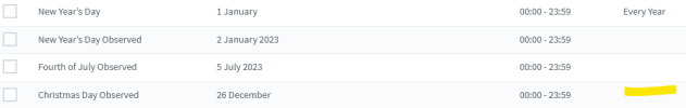

Interesting catch, I see this as well. 12/26 does not show every year:
but if I open it, without making any changes, it does show there:
(the other two "observed" days do show a year because I had already opened them and corrected them to 2023 to see what would happen)

Take a look at the picture I posted above. Before your edit, did that screen have text in the "is every year" column, where I highlighted in yellow? If it had been set to 2022 that column would have been blank.
