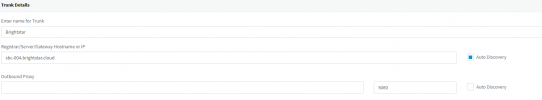

I have double checked the settings so they match the guide but the trunk won't register and I'm currently getting these messages in the events;
Registration at Brightstar has failed. Destination (sip:sbc-004.brightstar.cloud:5061;transport=TLS;lr;maddr=77.108.130.28) is not reachable, DNS error resolving FQDN, or service is not available.

Yes which registrar are you using in your set up? Are you using "sbc-002.brightstar.cloud" or "sbc-004.brightstar.cloud" ? Also is Auto Discovery enabled?
I've tried with both 002 and 004 but not had any luck, and auto discovery is enabled.
