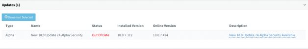

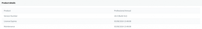

our 3CX is 18.0 (Build 312) (18.0.7.312, from the Update Page) (see attachment)
Clicking on the "Updates > Click here to visit update page" it does not give any error, actually.
I can see in the page that there is an update with Type Alpha (New 18.0 Update 7A Alpha Security - 18.0.7.424), but I have seen a post on the blog with the release of the Update 7, so it seems to me that the list is not refreshed correctly. (second attachment)

What you are seeing is actually correct. Version .424 was released as an optional security update and was followed by version .441 which is the more stable version. You could update to those if you'd like or wait for update 8 final which includes all the improvements plus much more.
The error you are seeing in the log is also normal. Is a repository that is no longer used but it does not prevent you from updating.
