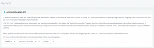

I would like to upgrade our 3CX Version 16.0.9 to version 18. However, after selecting "Updates", the upgrade button does not exist. Please refer below.
Kindly advise how can I upgrade to Version 18 ?
