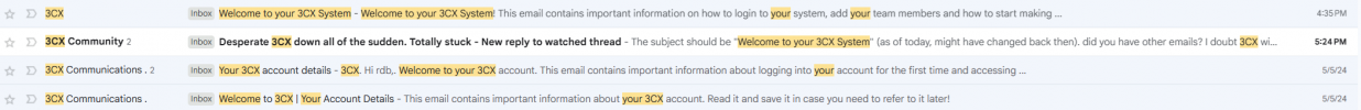

I suspect that the email you've screenshotted is the result of an extension creation rather then the system creation.
The subject should be "Welcome to your 3CX System" (as of today, might have changed back then).
did you have other emails?
I doubt 3CX will give you the full email of the system owner - maybe they'll give a hint?

I'm 1000% sure this was created under this email, I got all confirmation mails etc and don't use anyother email addresses.
