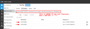

Hello Leejor,
In V20 the Inbound Rule tab is gone and replaced by Call Handling. I cannot specify the incoming DIDs here but just to select from the Trunk's DIDs.
After playing with it for a while it turns out I cannot add the DIDs for Flowroute's Trunk as the notification listed on the Trunk setup page.
I specifically changed my DIDs to e164 format after seeing this yesterday and it screwed up everything.
Dev team If this helps anyone, please update your prompt to have the correct information reflected.
Aslo the Trunk configuration page could use a bit more provider-specific instructions to avoid issues like this.
After changing all the DIDs back to the original format (Country Code + Area Code + Number = 11 digits in total) but without the +, everything worked as expected.
This worked for ONE of my clients. The other client is actually having the numbers setup in e164 format, but the inbound rule has no issues at all. I'm really confused now. Please see the screenshot below.
Check the medium+ activity log for the number to see what is being sent and how routing is handled. As noted above the * will match any characters so works as a catch-all for providers using different formats.
