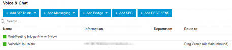

After updating to V20, why does Voice &Chat set the SIP Trunk DID's to destination, in my case a ring group, but call handing also has DID's associated with the main ring group? Seems redundant? Should I be setting the Voice & Chat routing to the default Department?

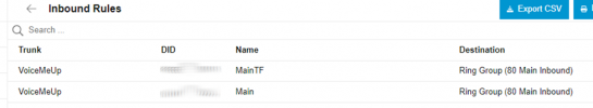

Inbound report looks good. Both DID's going to RG80.

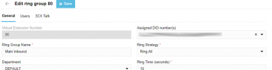

It still seems odd that Voice & Chat can route the DID's to a RG but in Call Handling, DID's are also assigned to a Ring Group, which could end up being a different Ring Group than that defined in Voice & Chat.
If you have DID point to the specific destination, it will be a priority order, and not the Default routing. If no DID assign, it will be used then.
