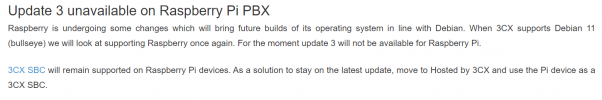

I have had an issue with no apparent cause where the install gets to 98% and then hangs and never completes. It then wants to debug if rebooted which is beyond me. I have reformatted and gone through the process again and same result. There was an issue with the mirrors failing but I managed to change to a mirror at a different address and they then loaded.
