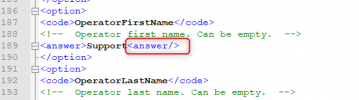

<code>OperatorFirstName</code>
<!--  Operator first name. Can be empty.  -->
<answer>Support<answer/>
</option>
<option>
<code>OperatorLastName</code>
<!--  Operator last name. Can be empty.  -->
<answer>Contact<answer/>
</option>

Hi @sud,
We've tested this and there is no problem. Ensure that the permissions on the file are correct, the format of the file is correct. If you continue to find this problem, I'd suggest remaking the config file and if the this continues to be a problem, contact Support to investigate.
After running it through a online XML validator, you have formatting issues:
