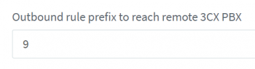

Hi, Sorry they are both using a 7 that was a typo. The customer has a few bridges setup and it is happening to all of them but not all the time and with no real pattern. The outbound rules are setup as per the below.
