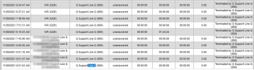

I've just had a call from one of my customers stating all their calls in a specific queue dropped at the same time.
This is the same time the queue statistics are set to reset, its the second time they've lost all calls in a queue at the same time but initially thought nothing of it.

I'd recommend maybe generating a Call Report too to make absolutely sure that this is happening exactly at the same time with to-the-second accuracy as it may very well end up being merely a coincidence.
Hi Chris,
is this the report you're referring to or is there a more details report that will tell me the time of disconnect?
I'm assuming the QCB calls are numbers below them?
I'll have to see If i can replicate it.
I did mean that one but I was hoping we could compare the ringing time to the time the call came in. In any case, the entries in the event log you posted are much more clear.
