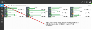

Take some screenshots from the webclient without the mobile app.
All you have to do is enable notifications on the web client.

That looks ok, is this without an registered mobile app?
Yes its super wierd. The windows app works fine as well.

If this is the web client of the extension that doesn't work you do NOT have notifications active. Please press the blue bell icon on the top left, as shown in my screenshot above.
Oh yes, i was blind... that is the thing we are talking about. you need to allow the notifications.
Reactions: jed
Damn it was the notification indeed. I feel dumb now.
