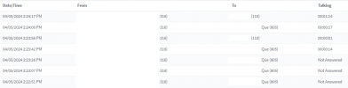

I want to add more detail, in the attached image multiple call attempts can be seen here when in actual the 1st 4 attempts experienced this on both ends:
-on caller end it just rings, no intro prompt is played, it rings for a while then it sounds like call is reconnected and it happened 4 times
-on callee end they tried to pick the call 4 times but it gave same error that transaction doesn't exist
on 5th attempt caller could hear the intro prompt as well as the call was picked. This whole process was a one continuous call means the caller didn't redial or the call wasn't disconnected.
