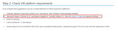

Please also check our installation guideline for the supported VM platforms and versions that are capable of running Debian12:
Yes we meet all those requirements, i will try to run a test tomorrow on another hypervisor, on a different network

Using all Gen 1, the guide from 3cx said not to use gen 2 Vm's, i'm assuming it's the hyper-v Manager issue, as in server 2019, Hyper V Manager 10, not expericing the same issues.
Windows server 2012 is not supported and perhaps the HyperV is missing updates that will allow the Debian12 installation.
