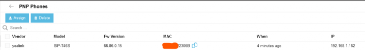

this is from the phone that I just factory reset.
It doesnt appear to be then pulling the config and setting itself up.
Its showing up in the PNP tab
Cant do much else - in v18 I could assign it again and it would pull, but it wont.
Am I supposed to do something? Do I need opt 66?
