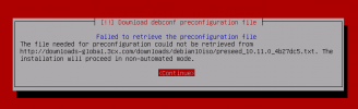

Hi again, I went with Debian and watched a few videos. Used the ISO from the website and keep getting the following
Can you confirm that the VM has an internet connection and a valid DNS server set? We recommend using Google's DNS servers as the primary server (8.8.8.8).
You can check what you have by running the following command via SSH:
cat /etc/resolv.conf
Also, make absolutely sure you've downloaded the latest 3CX ISO from our guide: https://www.3cx.com/docs/manual/installing-debian-linux-pbx/
Reactions: CentrexJ
10th time lucky, but i think i im getting there, thanks for the help
