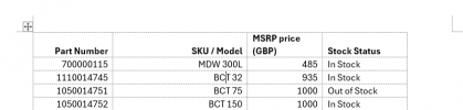

I then tried uploading a CSV and DOCX version of a basic list of products and whether they were in stock or out of stock but when I query the AI it completely ignores this document and just tries to put me through to a human who could answer the question.

I currently have it in as .DOCX file - the data is in a table within the document.
I have also converted it to a PDF - same issue..

When the AI answers it just says it does not have live stock data but can put me through to someone who can answer my question.
Sample from docx file in knowledge source:
It might not be able to parse the table properly in docx/pdf - perhaps if given as a plain text CSV?
