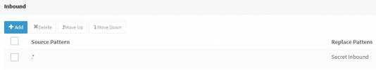

The only thing I can think of, but would strongly recommend against is:
In the Inbound Parameters set both the CallerNumber and CallerName to be populated with the "From:User Part". This will result in both fields to carry the caller's number. Then use Caller ID reformatting for Inbound calls to reformat the Caller ID from whatever it is to "Secret Inbound". The Caller ID will be displayed as Secret Inbound and the Caller Name will show the actual number, so all required information should be displayed on screen. The problem with this is that you will not be able to dial the number back because you will actually be trying to use "Secret Inbound" as the calling number. You can of course manual dial the number though.
For The Caller ID reformatting you could use something like:
That solution's not bad.... it gives me control of the first line, but like you say at the expense of the caller ID functionality. I'll ask the users which approach they prefer and go with what they say. Thanks. I am too much of a noob to make a feature suggestion, but I think this ability would be good.
