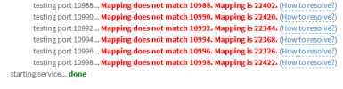

Firewall Check: Because I never intended to access the 3CX Dashboard/Console outside of my local Network I never forwarded any Ports at my Router. The Results will be attached. My Internet/Phone Provider is Vodafone and the Fritz!Box also is from Vodafone and the SIP is running over the Fritz!Box but everything (also the SIP-Trunk) is local so I believe technically I'd be my own SIP Provider.
