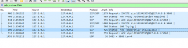

In activity log, I see this when I try to make outbound call: 10/03/2021 1:37:27 AM - : Failed to create outbound lines to call 18194255555
And the most interresting is when I capture the trafic during call:
Why the source and destination IP is localhost??? Is there an option that I missed somewhere else???
Thanks!
Bigmat
Might be good to put system in verbose to see what is going on or what outbound rule it is using.
Since twilio is IP based you shouldn't see authentication required and it is odd that it shows localhost. Also, twilio requires E.164 so the call should show [email protected]
What you are looking at is the internal communication of the PBX to probably a 3CX client. That is why you see local host and authentication requests.
The first step is to check your outbound rules and see if everything is ok there and try to simplify them for testing. For example add only the extension you are using in the call from extensions and your trunk in route and leave everything else empty for testing.
