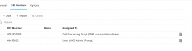

You have a DID defined ending in 802, yet the invite coming in is ending in 801.
I'm really bummed out by this new v20.
The PBX is receiving a call from a DID that it is not configured to process. How is this the fault of Version 20 is beyond me.
Reactions: bitn2
Thanks @NicholasP_3CX for your advice. I've mistakenly posted a log which captured for the configured 801 DID. I have defined DIDs for 802 & 801. It was my silly mistake posting the logs for 801 which differ from my screenshot configuration.

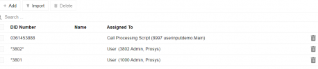

Define the DIDs as *3801 and *3802 and see if that makes a difference.
I have tried to define the DID as recommended and it doesn't seems to make a difference.

The DID defined as advised:
I was trying to define *3802* to see if that makes a different and it's the same.
