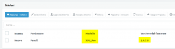

The main ticket has been closed as resolved but the 3cx problem is not because if you select the extension in the telephone screen and assign it to an extension only the X3U template appears and not the X3U PRO. Otherwise, by adding the phone from the user screen with the correct template and mac address it is supplied but in phones I am left with the attached screen

Most likely again this is because of wrong firmware.
Please notice how my user agent appears for the correct firmware version:
So when I assign it automatically, the system detects it as a X3U Pro
Finally the phone provisioned with the correct language and time:

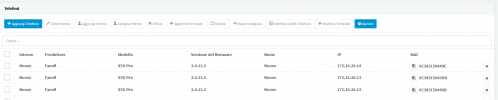

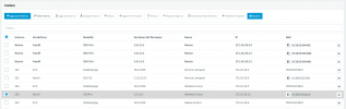

The attached screens show you that the phone appears 2 times and in the correctly supplied one I have inhibited functions such as reboot.

Today I realized that if I selected assign extension from the phones menu it automatically set the model as X3U without the possibility of changing it. Differently, adding the telephone from the telephone provisioning users menu is associated correctly but remains as in the screens in the telephone menu.

As per provided screenshots you are using X3U PRO and the firmware should be 2.4.7.5
