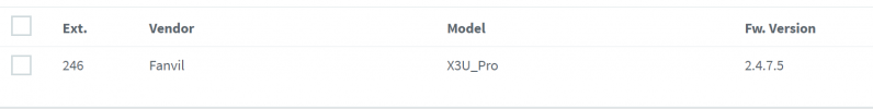

Instead the problem was actually 3cx I noticed that the phone was recognized as X3U and not as X3UPRO I had to delete the extension and recreate it manually not as self-recognition and now everything works even internal ntp
I disagree entirely that this is a 3CX issue. The evidence can bee seen in your screen shot we can see you are using the wrong firmware with the wrong user agent being sent to 3CX.
3CX cannot recognize the phone correctly and assign the right settings if you are not using the correct firmware.
Please install the supported version version as per here so it can be recognized correctly like you see in my example below:
