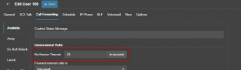

Whats your ringing timeout? You might have inadvertently changed this value to something ridiculously low and it doesnt give a chance for the extension to ring
It's set to 60 seconds, I bumped it up from the default to make sure it wasn't holding some different value than what was displayed. I'll try to get more details on the issue. I removed our Teams integration and the problem remains.
