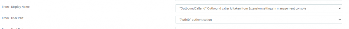

Hi @Pascal Stekelenburg,
Does this happen for all outbound calls that you make?
Can you check the Outbound Parameters and tell me what values you have in the From : Display Name field and the From : User part field?
So, the originating DID is being send as the number, and the name? Since the format of the number(s) is lacking the prefixes you desire, and it is a DID, and not the "main" number, I would suspect that the outbound caller ID, set in the extension settings, may require changing, as a start.
Yes it is with all calls.
What you could do is try to change the From: Display Name to Custom and call again, I may render no result. If it doesn't, then I'd suggest speaking with your provider about this. Ask them why this specifically is happening. If they give you a solution that you're able to implement, let us know and we'd be happy to help.
