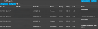

In my call log it keeps showing that I have terminated the call

I'm going to assume that when a call is answered, an unacceptable reply is received by the provider, then the call is dropped. Without being able to see the 3CX Activity log, or using something like Wireshark, or getting your provider to help troubleshoot, it is all a guess at this point.

Looking on the call record for Voicehost it doesn't show that an incoming call was attempted but on the 3CX call log it does show an incoming call was attempted and says it got terminated.
