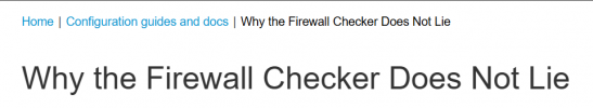

Clicking on one of those links on the right will take you to the document explaining what the firewall check does and you can use this to configure your firewall accordingly.
https://www.3cx.com/docs/firewall-checker/

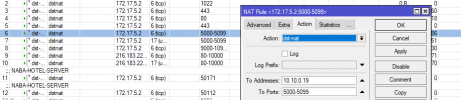

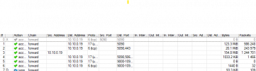

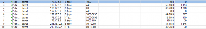

I am using a routerboard..
There is one more thing I need an answer, until the latest update, no changes were made on any thing even on network side or 3CX side. It was working perfectly without a single issue.. All the incoming and outgoing calls had no issues at all. So why all of a sudden it could be an issue with firewall after this latest update?
