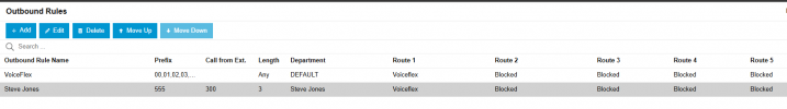

Here are the two screen shots, (just so you know the #### is where my mobile number is entered)
So in theory only me in the department "Steve Jones" should be able to dial 555 and which forces the system to dial my mobile.
But any user can dial 555

In the Outbound rules some elements are OR and some are AND. Avoid using an extension and a Department limit at the same time.
Also here I would leave the length empty.
The below, with the right department, should be enough (I tested calling my mobile when dialing 555 and being in the Default dep, where other users not in it could not -
Set limits to 555 prefix and Department needed, nothing else.
Rule was placed first, but should work as second in your case.
stripping 3 digits and prepending my whole number):
