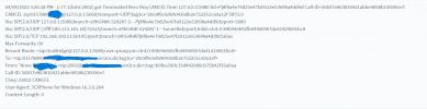

So i changed it to verbose and made another call - came through but as anonymous. Here's the log for the call:
as a test, set a manual phone number in your countries format, and make sure there are no dashes, letters, or special characters. It looks like it might be sending the customers name rather than the phone number according to the logs.
We ran into this issue when we tried to send our business name in the phone number field, it used to work, but our country changed routing rules.
It seems you are looking at the wrong place. You posted a Cancel message from the 3CX Phone for Windows.
You are looking for an Invite message from the PBX. The user agent should be 3CXPhonesystem

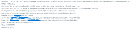

thanks for your help and patience. I'm new to 3CX and VoIP and still learning a lot. following two new screens with "invite". That's a outgoing call from the 3CX softphone ext. 2001 to an external mobile phone no.01578xxxxxx (the call came through, but as anonymous as described before). I can unfortunately only find "3CXPhone for Windows 16.3.0.264" as User:

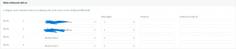

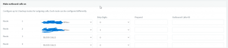

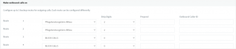

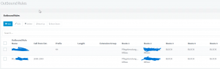

@leejor i have implemented two outbound rules as followed:
The oubound number-fields are empty though:
Hope these screenshots help you guys further out.

I would try putting a number into the outbound caller ID field, in the outbound rules, to see if you can, at least, get that working. It may be that the number you are using, in the outbound caller ID for the extension(s), is not accepted by your provider, as the format is incorrect, or, it may be that the outbound settings, for the trunk, are not set to use that caller ID. If you put something in the outbound rules, then it will override any other number. You might want to confirm with your provider exactly what format they expect.
