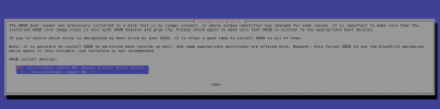

I had a similar issue with multiple instances failing to upgrade from 18.0.8.939 to 18.0.9.20 all running on light sail.
I rolled most of them back to 18.0.8.939 but one i couldn't, running "sudo dpkg --configure -a" made it update and now is working. You can see what came up when i ran it attached as pic. Then the error below
Reading database ... 52837 files and directories currently installed.)
Preparing to unpack .../3cxpbx_18.0.9.20_amd64.deb ...
Removed /etc/systemd/system/sysinit.target.wants/3CXFirewall.service.
Removed /etc/systemd/system/3CXQueueManager01.service.
Removed /etc/systemd/system/3CXMediaServer.service.
Removed /etc/systemd/system/3CXPhoneSystem01.service.
Removed /etc/systemd/system/3CXCallFlow01.service.
Removed /etc/systemd/system/3CXSystemService01.service.
Removed /etc/systemd/system/3CXEventNotificationManager.service.
Removed /etc/systemd/system/3CXIVR01.service.
Removed /etc/systemd/system/3CXCfgServ01.service.
Removed /etc/systemd/system/multi-user.target.wants/3CXQueueManager01.service.
Removed /etc/systemd/system/multi-user.target.wants/3CXMediaServer.service.
Removed /etc/systemd/system/multi-user.target.wants/3CXPhoneSystem01.service.
Removed /etc/systemd/system/multi-user.target.wants/3CXCallFlow01.service.
Removed /etc/systemd/system/multi-user.target.wants/3CXSystemService01.service.
Removed /etc/systemd/system/multi-user.target.wants/3CXEventNotificationManager.service.
Removed /etc/systemd/system/multi-user.target.wants/3CXIVR01.service.
Removed /etc/systemd/system/multi-user.target.wants/3CXCfgServ01.service.
Removed /etc/systemd/system/multi-user.target.wants/3CXAudioProvider01.service.
Removed /etc/systemd/system/multi-user.target.wants/3CXGatewayService.service.
Removed /etc/systemd/system/multi-user.target.wants/3CXPhoneSystemMC01.service.
Removed /etc/systemd/system/3CXAudioProvider01.service.
Removed /etc/systemd/system/3CXGatewayService.service.
Removed /etc/systemd/system/3CXPhoneSystemMC01.service.
Unpacking 3cxpbx (18.0.9.20) over (18.0.8.939) ...
Setting up grub-pc (2.06-3~deb10u4) ...
debconf: unable to initialize frontend: Dialog
debconf: (Dialog frontend will not work on a dumb terminal, an emacs shell buffer, or without a controlling terminal.)
debconf: falling back to frontend: Readline
Configuring grub-pc
The GRUB boot loader was previously installed to a disk that is no longer
present, or whose unique identifier has changed for some reason. It is important
to make sure that the installed GRUB core image stays in sync with GRUB modules
and grub.cfg. Please check again to make sure that GRUB is written to the
appropriate boot devices.
If you're unsure which drive is designated as boot drive by your BIOS, it is
often a good idea to install GRUB to all of them.
Note: it is possible to install GRUB to partition boot records as well, and some
appropriate partitions are offered here. However, this forces GRUB to use the
blocklist mechanism, which makes it less reliable, and therefore is not
recommended.
1. /dev/nvme0n1 (64424 MB; Amazon Elastic Block Store) 3. none of the above
2. - /dev/nvme0n1p1 (64423 MB; /)
(Enter the items you want to select, separated by spaces.)
GRUB install devices:
Hi there,
I understand this is a problem but also keep in mind, that this is not happening for everyone. So we need to tackle this on a case by case basis. However, this is an interesting one. Let's break this down.
My opinion goes like this:
  1. 1 or 2 years ago you installed 3CX on OVH
  2. Time passed. You are happily running 3CX.
  3. In this time, can we/you be 100 % sure that nothing changed in the OS? The answer is No because you are not the sole maintainer of a cloud hosting instance and time passed.
  4. Now 3CX presents a U9 script that updates on the majority of instances, but fails in yours.
  5. It also fails specifically because of GRUB - the Grand Unified Bootloader was installed on a disk that is no longer available (Quite a serious issue to be something related from our script) - or the GRUB identifier has changed. (Which implies that it was moved)
The below is a complete list of all the issues that can cause this problem.
  1. Change in Disk Configuration:
    • If you've made changes to your system's disk configuration, such as removing a disk or changing its partition structure, the unique identifiers for the disks or partitions may have changed.
  2. Disk Failure:
    • If the disk on which GRUB was originally installed has failed or is no longer accessible, GRUB won't be able to find its components.
  3. BIOS/UEFI Changes:
    • Changes in BIOS/UEFI settings, such as the boot order or disk configuration, might affect GRUB's ability to locate the necessary components.
  4. Operating System Updates:
    • System updates, particularly those related to the kernel or GRUB itself, can sometimes lead to inconsistencies between the GRUB core image, modules, and configuration files.
  5. Reinstalling or Changing Operating Systems:
    • Installing a new operating system or reinstalling the existing one might overwrite or modify the GRUB configuration.
  6. Disk Renaming or Reordering:
    • If the disk naming or order changes (e.g., from /dev/sda to /dev/sdb), GRUB may not be able to find the correct disk.
  7. Incomplete GRUB Installation:
    • If there were issues during the initial GRUB installation, such as interrupted installations or incomplete configurations, it can lead to synchronization problems.
So if something from the above points happened here, the default update script will not work. I can also honestly see these things happening over the lifetime of a hosted linux image - And I doubt you as a client will be informed of this. For example, the hoster can handle disk failure without even informing you. You just see a 2 minute downtime reported on the site. You cannot always know exactly why that downtime occurred.
Thankfully, Linux gives you a solution to fix this. So yes, let us be prepared to run sudo dpkg --configure -a.
Conclusion: It is impossible to make 1 upgrade script, that upgrades all the machines in the world, in all the environments they are installed on, catering for all the operating and cloud hosting changes that could have been made during this time.
So let us be prepared to keep an eye on these issues and of course always welcome to report them here. We will always look into each issue and together learn on ways to improve.
Thanks for reporting.
