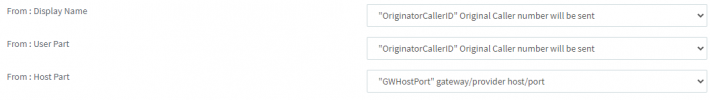

The option "OriginatorCallerID" will retain the original caller ID when transferring a call back out in most call scenarios. Depending on the SIP headers you are using to read the caller ID from in the Asterisk side you should adjust accordingly.

It works when I don't have a fixed outbound caller ID set in the outbound route.
In my case I have an outbound caller ID in the asterisk route, in this case I think the only way for this to work is if I remove the outbound caller ID from the route, right?
...or create a second route, used only for forwarded calls, that makes use of a different prefix, and is not assigned a fixed caller ID.
Yes. If you have a caller ID in the outbound rule route, that bypasses everything. You should remove that if you want it to work.
