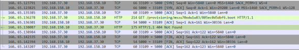

I'm no wire shark god, but this is what i see.
Get
HTTP reply
its saying 404 to this file

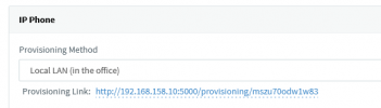

http://192.168.158.10:5000/provisioning/mszu70odw1w83/805ec0d5dbf6.boot
this file does not exist.
But that's the provision link
What am i missing?
Thanks for any help.

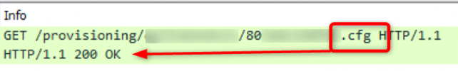

A little note regarding provisioning: Just to put your mind at ease, so long as the .cfg file gets transferred you are good. Not all the files you see the phone requesting are needed for successful provisioning. We do not provide those at all so no need to worry about it for now.

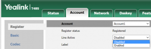

2. disable the account on the phone, and Apply
3. Open a 2nd tab, and start a capture on the phone so we can see if it sends a REGISTER (Settings>Configuration>Pcap)
4. go to the 1st tab and enable the account and hit apply
