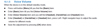

I'm not familiar with that model, but I've used other Fanvil handsets that allow you to alter the microphone gain.
This pic might helpful, however it's not clear whether by 'voice' they mean the earpiece volume or the microphone volume:
Thanks Lee - confirm volume is set at maximum
