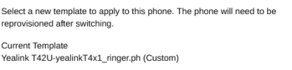

I've attempted to switch the phone template to a custom one but get the error:
I only added 1 line to set minimum ringer volume.
Edit:
Im unable to swap to custom template even if I make no changes to the default.

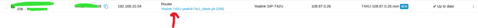

Solution
I deleted the phone and added it back and Im now able to switch templates and the payload is the correct interface FQDN.
So one to note for anyone else who does a restore via CLI when switching FQDNs.. best to remove/add the phones to remove whatever residual records exist.
No, thats the problem.
if you look at previous screenshots.
When I deleted/added the phone I used the blank template.
Then I switched to the one with ringer appended.
Although this change is shown when I go to switch again, it doesnt show on this main page.
