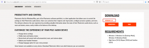

Yes, there were some other issues in versions after 3.19, but I think Plantronics intends to fix them in 3.22.
Also are you sure you have 3.22? I don't think this has been released yet. I think the latest on their website is 3.21...
